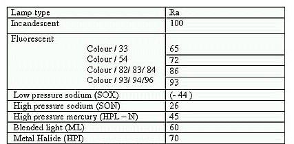

以下是經常被選明燈具的演色性指數 ( Ra 指 Rendition absolute )
圖:
Lamp type = 光源種類
Incandescent = 白熾燈泡
Fluorescent = 日光燈管
Low pressure sodium = 低壓鈉燈泡
High pressure sodium = 高壓鈉燈泡
High pressure mercury = 高壓水銀燈泡
Blended light = 免用安定器水銀燈泡
Metal Halide = 復金屬燈泡
